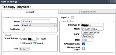

I have to migrate an old deploy with APs 39XX on V2110 controller (Identify) to a new XIQC controller and I´m so confused about XIQC´s AP adoption process.
Now the APs have a VLAN to connecto to Identify controller and it gives the DHCP to them allowing registration.
so in the same VLAN the APs "discover" the controller.
I want to maintain the same simplicity in the new deploy, but Im reading the registration process on XCC and it talks about DNS and DHCP option. (doc "Extreme_Campus_Controller_v5.46.03_Deployment_Guide.pdf" page 17)
One of the methods talks about "The AP sends a multicast SLP request, looking for any SLP Service Agents providing the Extreme Networks service. " so my doubth is , Does it allow register APs to a controller in the same L2 domain without configure DHCP os DNS options?
