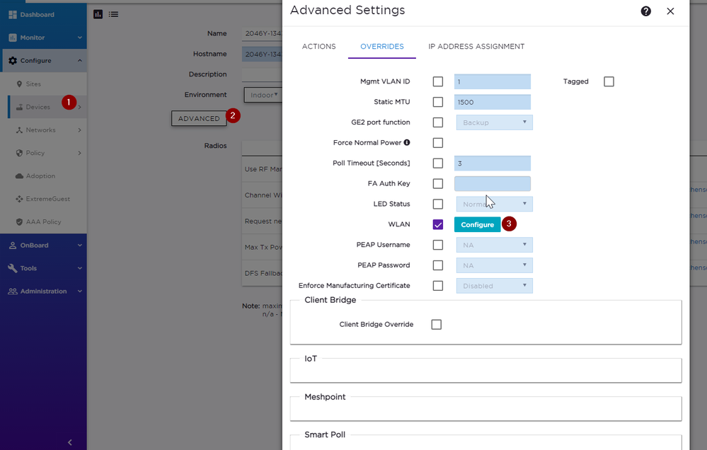

10-04-2021 11:50 AM
Hello Claudio,
The SSIDs are configured via the device group and the associated profile for the AP.
I suspect you can write your settings (hence status 200), but the data will be overwritten by the configuration in the DeviceGroup/Profile.
Try to set the checkbox in the “Advanced Setting” of the AP. This is for SSID/WLAN override.
