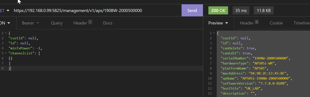

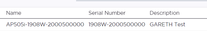

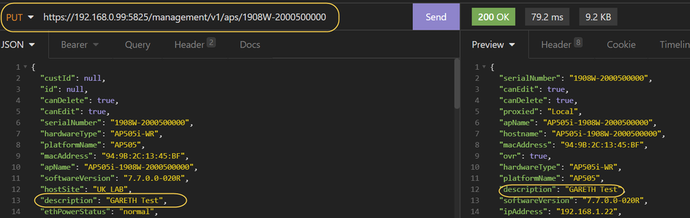

Hi Franz
I would recommend in the early stages to use a tool like Insomnia or Postman to test out your calls while you get used to the formatting etc.  I have attached a json from my lab but it's better if you pull your data first with a GET then make your change with a PUT.  In this example I changed the description from NULL to "GARETH Test"
Screenshots from insomnia:
GUI:
I hope this helps
-Gareth
