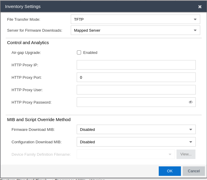

I have an edited device file which uses tftp to copy a file.  I can select it in the XMC gui and although I select TFTP as the file transfer method when I attempt to save the inventory settings I get the error "the selected script does not match the selected file transfer method"

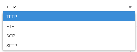

If you right click on a device and then select the "Archive-->Inventory Settings" option you get a dialog as follows:
Here you can select the file transfer protocol:

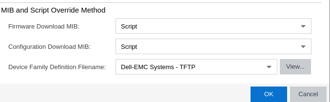

I am looking at this right now and there are two things:
  1. I don't know where these scripts are created or located ( guessing I may need to root around from the linux CLI )
  2. I don't understand the syntax of the script
I will add more information if I get anywhere with this.
So it seems that the file location question is answered at the following URL - https://extremeportal.force.com/ExtrArticleDetail?an=000091050&q=What-directory-do-you-put-custom-d...
The actual file path is:
/usr/local/Extreme_Networks/NetSight/appdata/InventoryMgr/properties/devicefiles
In that directory you find a file "DeviceFamilyDefTemplate.txt" that describes the format of a device file ( in some detail ).
Note that there are no other files in the directory so I don't know where the files are for the existing devices ( like a Cisco router for example ). I copied and pasted the Cisco example from the web interface into a new file "myNewDeviceType" in the directory and replaced Cisco with Dell-EMC inside the file and then I got a new option showing up in the Web interface:
