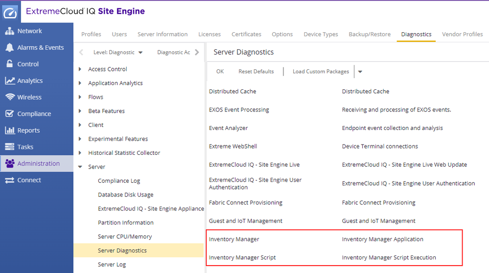

Thanks Zdeněk Pala,  the server diagnostics is very useful for this and many other things!

The File transfer method is set to TFTP, but I still get the error:
I have set the server logs to verbose for Inventory Manager and Inventory Manager Script, the script appears to run, but then it appears to run an unrelated script (Forti analyser script SCP)?:

The protocol defined in the script (e.g. TFTP) must match the protocol defined in the GUI. check screenshots in this thread.
There is a debug available => you will see all that is happening in the server log file.fcedb5e71bfc464185dac4dffa265f80.png
