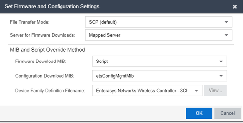

When I try to backup controllers configuration via XMC (ver. 8.1.5.22) I get the following error:
Archive Save Management Center Archive: (192.168.10.122) Version Stamp: Nov 1, 2018 3:54:29 PM - Configuration Upload script is empty in file Enterasys Networks Wireless Controller - SCP :
Is this a known problem?

Using these settings worked, thank you.
Ronald_Dvorak
Honored Contributor
I get the same error with the settings you've posted in the screenshot.
Change it to the below - that works for me....
d4e514b04486435594a4be1d0acf081a_RackMultipart20181106-57800-1nqh3l8-XMC_controller_backup01_inline.png
