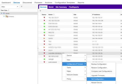

‎11-03-2018 08:28 PM
Hello,
Check out this article:
https://gtacknowledge.extremenetworks.com/articles/How_To/How-to-use-Inventory-Manager-to-backup-Ide...
It's a little old, but you should be able to find the same option in Extreme Management Center --> Administration --> Options
Let me know if this helps. I'll flag the article to be updated.
Thanks
-Ryan
Thanks
-Ryan

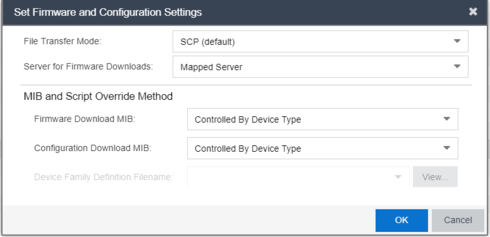

Hello Rahman,
as I posted above you should use controlled by device type not Script.
Best regards
Stephan
Best regards
Stephan
Regards
Stephan

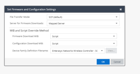

Hello Ryan,
Yes, I checked the scp server password, it is OK. The error says script is empty but it is definitely not:
