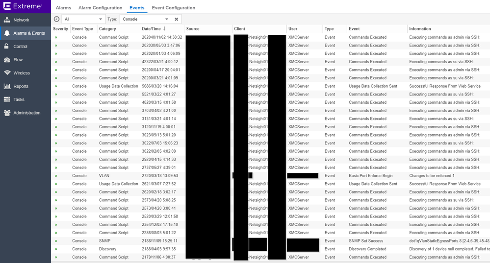

I’ve a customer XMC installation where we have a lot entries in console log / events with broken date-strings and so the ordering function is not working correct anymore.
Can some tell me, how can I fix this issue / delete the entries?

thanks for your reply. I always checked console.log & admin.log but I can’t find entries with such broken time stamps.
I didn’t count the number of entries with broken time stamps, but it’s round about 1.2 pages. The other entries are normal.
Do I need to look into the databse for deleting this entries?
