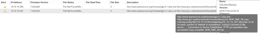

This works without issue as shown with the inventory script verbose logs enabled in XMC, below is an extract from the server.log file showing the commands where successful:
BHR_N9K_2# copy running-config tftp://10.10.15.50/configs/tmp/10_10_15_247.cfg
Enter vrf (If no input, current vrf 'default' is considered):
Trying to connect to tftp server......
Connection to Server Established.
TFTP put operation was successful
Copy complete.
BHR_N9K_2# exit
2019-11-05 22:07:22,300 DEBUG [com.ets.netsight.inv.agent.ScriptMib] [Inventory Snmp-10] [ScriptMib] [10.10.15.247] Looking for success regex match: bytes copied:
2019-11-05 22:07:22,300 DEBUG [com.ets.netsight.inv.agent.ScriptMib] [Inventory Snmp-10] [ScriptMib] [10.10.15.247] No match for success regex match: bytes copied:
So the script is executing without error but is showing a failure in XMC:
The only bit I am considering as perhaps the issue are the last two lines in the server.log file given above:
Iā€™m not sure if this is why or what regex match is configured or looking for? Maybe a match on the ā€˜Copy Completeā€™ on the Cisco transcript when the TFTP upload has been completed?
Thanks in advance.
1 ACCEPTED SOLUTION
Zdeněk_Pala
Hi Marin.
the script does expect text ā€œbytes copiedā€
the cisco does report ā€œCopy completeā€.
As these doe not match => the backup failed.
change the BEGIN SUCCESS section and you will be good.
then please share, so others can benefit also.
Regards Zdeněk Pala

Thanks Z, worked perfectly as you said. Script below, download section needs amending and testing, but easy enough now the detail has been teased out with the upload section:
-- Use these scripts to manage Cisco devices
name="Cisco Systems Adapted - TFTP"
desc="Cisco Systems NEXSUS SSH/TFTP Scripts"
protocol=TFTP
-----BEGIN SCRIPT "Configuration Upload"-----
copy running-config %TFTP_URL%
@KEY %0D
@receive 40
exit
-----END SCRIPT-----
-----BEGIN SUCCESS "Configuration Upload"-----
Copy complete.
-----END SUCCESS-----
-----BEGIN SCRIPT "Configuration Download"-----
enable
%ENABLEPSWD%
copy %TFTP_URL% startup-config
startup-config
@receive 60
exit
-----BEGIN SUCCESS "Configuration Download"-----
bytes copied
Appreciate the help.
