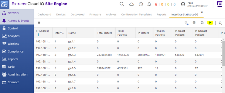

Hello,
Do you see a green "Play" icon in the top right hand corner of the flexview? This should retrieve another set to information from the devices when pushed.:
Thanks

It's been a while since I set up a custom DeviceView but if memory serves this function is more of a snapshot at the time the DeviceView is opened than live. While some functions built into DeviceView have a refresh button - most do not. I suppose a feature to 'Refresh' the DeviceView vs close and reload might be doable but this would have to be discussed with your @extreme account team.
I don't think there's a function to add a 'refresh' button to custom views, like the ones you are able to grab from GitHub.
