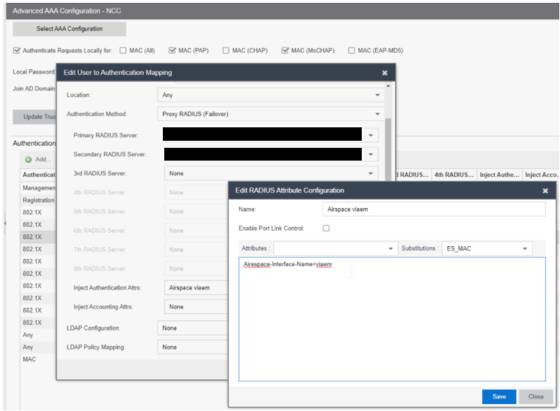

The deletion and insertion (or replace, depending how you look at it) of attributes is required when proxying the request, which is defined here:

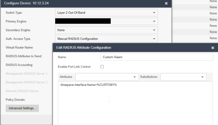

The section in part, mentioned above I believe is the other direct, when ExtremeControl intercepts and relays the authentication request back to the originating RADIUS server, which is configured here:
So the question is the latter would replace the AVP attributes with whatever I have configured, but what I actually need is to either only send specified attributes to the proxied server or remove / delete what's being sent via the originating RADIUS server.
The configuration is:
Which implies it is only injecting (appending), rather then replacing?

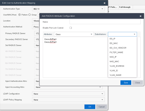

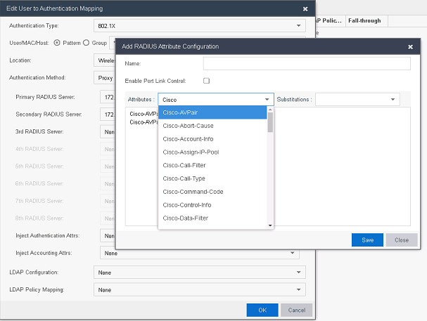

Can you give an example for the delete portion? If NAC is acting as the terminating RADIUS server we won’t need to delete any attribute, we just won’t add it.
If you’re in a proxy RADIUS environment the default action on a profile is to “Replace RADIUS attributes”. So if an AVP is defined in NAC it will replace any of the same attribute returned from the proxy RADIUS server.
If you want to completed delete an AVP and not replace it with anything, that is a situation we’ll have to talk further about as NAC can only delete attributes that it will replace.
As far as injecting an attribute NAC can inject RADIUS attributes to be proxied to other servers.
