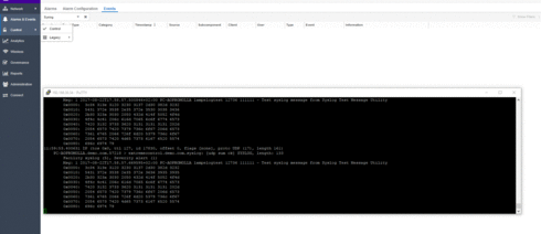

Hi, I've got in my demokit environment a strange problem.
My EMC for some time has worked well as syslog server, but not despite the fact that I see the syslog messages correctly received in the /var/log/syslog file
46241964734d42b9b20740b9ee49a044_RackMultipart20170823-128207-85qw8c-Capture2_inline.gif
in the Oneview page or in console, these messages are not shown.
If I made a tcpdump on EMC interface where receive the syslog messages, I see these message:
46241964734d42b9b20740b9ee49a044_RackMultipart20170823-88554-sd5fmk-Capture2_inline.gif
and with netstat -na I see the port 514 correctly open and the syslog process is running.
I've also tried to made a backup of the EMC server and to install a new one and restore the previous configurations, but the problem still remain.
How I can debug this problem more in deep for resolve it?
Thanks

I've found the problem was infact due to an error setting in the syslog alarm manager where the path were set to /var/log/messages instead to /var/log/syslog
6b9388d882f8428a9633c304cbcafbce_RackMultipart20170823-95659-m703dl-Capture2_inline.gif
The strange is why tis path is changed for some reason (for several time the syslog has worked without problem).
