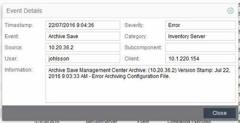

fd22854e250d4aa3b78200b7d982030f_RackMultipart20160722-10582-ojl6rz-Capture_inline.jpg
Here's what the Inventory server log recorded:
fd22854e250d4aa3b78200b7d982030f_RackMultipart20160722-130688-90ol06-Capture2_inline.jpg

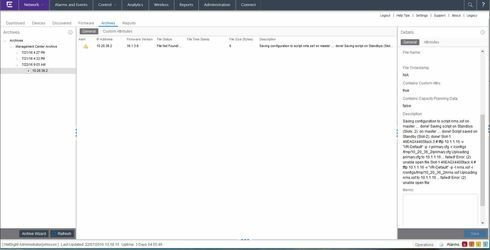

Not so, Ronald. That error above was from Command Center. I wasn't asking about how to use the legacy application called Inventory Manager, which is a Java app. I don't want to use those old Java based legacy applications.
I can watch the folder on my Command Center server b:/tftpboot/configs/tmp/10_20_30_40/, and I can see Command Center create the files: nms.xsf, and primary.cfg, with filesize zero, as I'd expect to happen.
That's as far as it gets, until the archive fails, and I see another copy of the above error.
