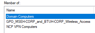

we have a group for Domain computers, when I browse AD i can see my host is a member of 3 groups, one being Domain Computers.
I want to use this group to reference as a memberOf attribute in the LDAP host group and then use this as a condition in the rule.
when I test my host it only reports back the other two groups under the memberOf attribute.
I’ve asked my AD guys if they can think of why it doesn't report the Domain Computers back as a value, see below;
doesnt report the Domain Computers value. They’re all security groups.
I’m told the account used in the LDAP config has read access to the Domain, perhaps this is not enough?

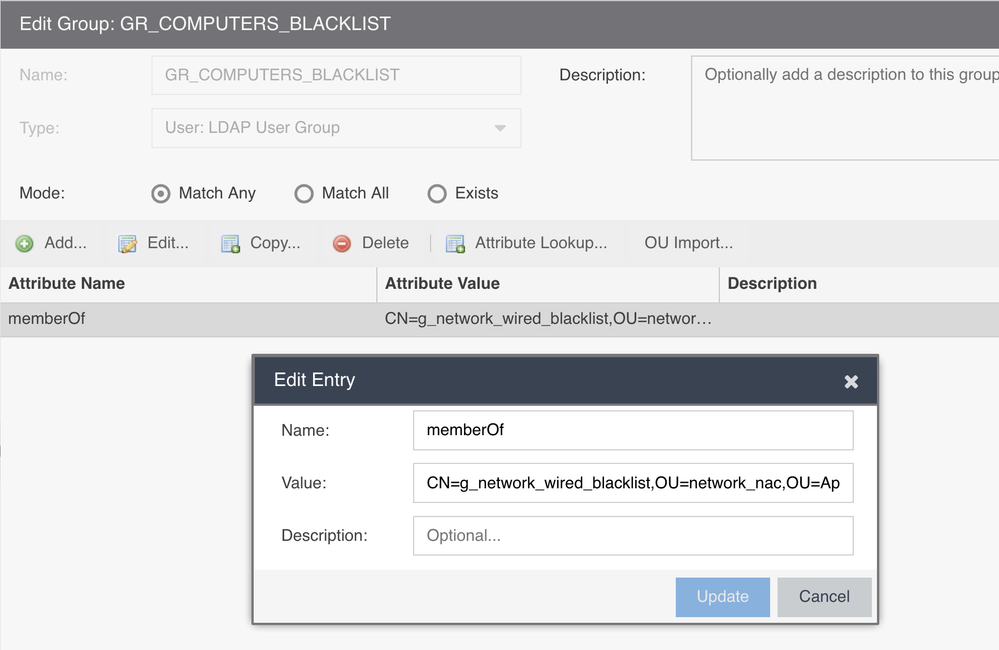

Miguel-Angel_RO
Valued Contributor II
Ian,
You can use any attribute refering the object in the AD.
Your missed test is probably a syntax isue.
Here an example for the memberOf attribute
If you want to use another attribute, just change the name of the attribute
Mig
