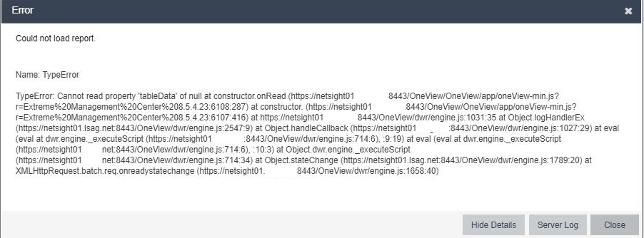

Hy,
I installed Netsight 8.5.4 this week.
All seemed good so far, today I needed to change a NAC rule.
After Adding a new rule, I was not able to view NAC rules in oneview anymore?
Did anyone else already install 8.5.4 and can test this?

02-04-2021 07:58 AM
I did what you told me.
After reboot of netsigth I could not see any errors during startup.
I added a rule and hit SAVE
2021-02-04 08:56:06,134 ERROR [com.enterasys.netsight.tam.server.webapps.monitor.configuration.NacWebConfiguration] Could not load table data.: java.lang.IndexOutOfBoundsException: Index: 101, Size: 101

2021-02-04 08:56:06,136 ERROR [com.enterasys.netsight.tam.server.webapps.monitor.configuration.NacWebConfiguration] Could not create table data for type: rules(2017)
