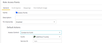

you are probably just missing this setting here:
I guess it is set to "permit traffic", change it to "contain to VLAN" and choose VLAN2005 from the dropdown.
By the way, if you only want to do VLAN assignment without any specific roles/rules/services, you can simply rely on RFC3580 without the use of policies. Policy aissgnment is done via Policy Mappings in NAC. Make sure to change the radius attributes of the switch to "RFC 3580 - VLAN ID & Extreme Policy" to be able to use both RFC3580 and Policies. "configure maptable response both" also needs to be configured on the switch.

I would agree. The "VLAN Egress" tab is meant to allow configuration of VLANs on egress, but not for PVID.
"Contain to VLAN" should set pvid and egress of untagged.
