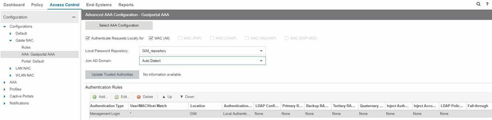

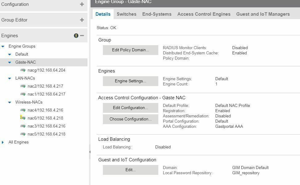

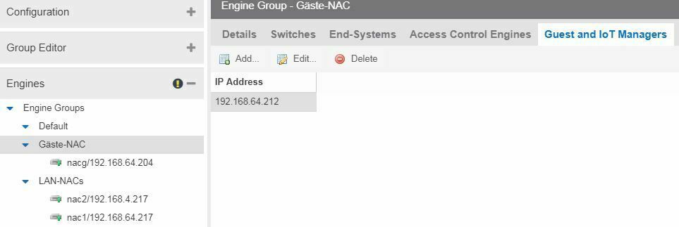

Guest and IoT Config is provided with a domain and a password repository:
This password repository contains one User, which is enabled, but has no GIM checkmark.
Engine group "Gäste-NAC" has an own AAA configuration ("Gastportal AAA") which puts requests from location GIM to local auth "GIM_repository". I have no LDAP configs there since I test with local reository only.
Location group "GIM" contains: switch 192.168.64.212, Port: *, AP ID: *
Everthing is enforced, but I still get error: "Error fetching Guest Users. Error on Access Control Engine/XMC.
Please check to make sure that your GIM configuration (Manager and GIM domain) on XMC is set correctly."
Does anyone have an idea?

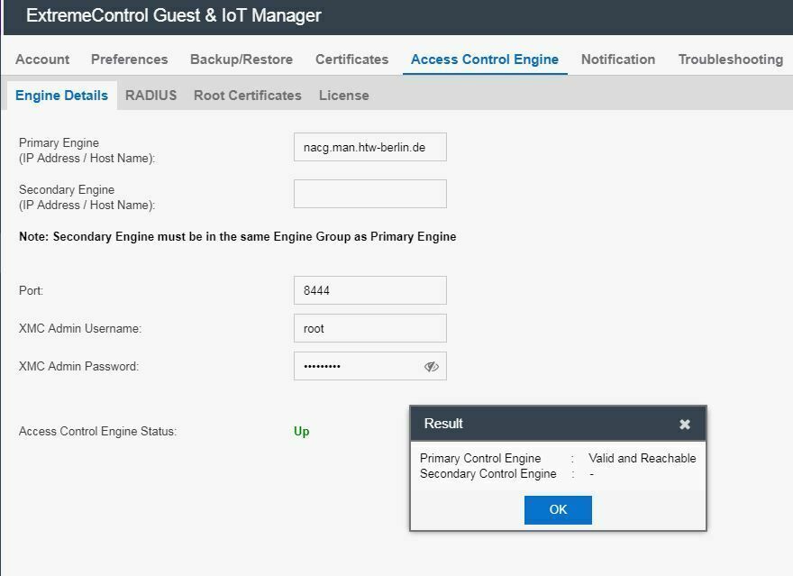

‎06-19-2019 12:58 PM
Can you confirm on your GIM administration screens that you have the correct gateway identified, shared secret for RADIUS processing to the gateway and that the XMC admin user name and password (or a user with proper GIM administration rights) is configured?
