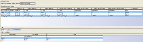

Is an SNMP credential on the controller with the correct CLI credential assigned?
9e4a623bbbb24365a7081a5623338f96_RackMultipart20150610-30191-1h2ial6-EWC_Firmware_Upgrade_error3_inline.jpg

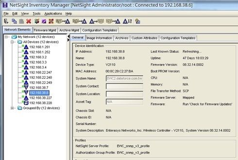

In Inventory Manager if you select the controller and go Tools ----> File Transfer Method does it show as using SCP?
9e4a623bbbb24365a7081a5623338f96_RackMultipart20150610-10823-1ofvijn-EWC_Firmware_Upgrade_error4_inline.jpg

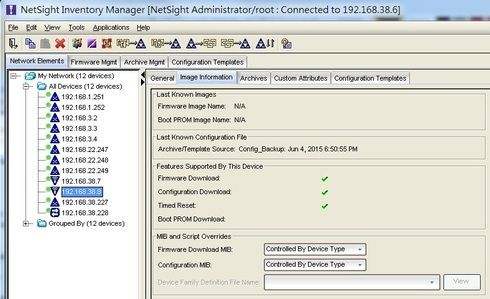

If you select the device and hit the "Image Information" tab do you have "Controlled by Device Type" for the "Configuration MIB" field? Does the directory root/configs/tmp exist?
9e4a623bbbb24365a7081a5623338f96_RackMultipart20150610-8383-b96hxl-EWC_Firmware_Upgrade_error5_inline.jpg

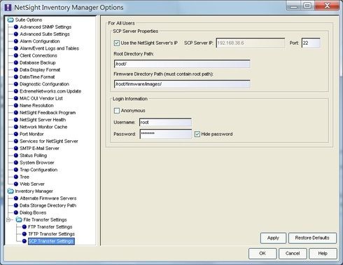

Under Tools ---> Options ----> File Transfer settings -----> SCP Transfer Settings ----> do you have the correct login information defined?
9e4a623bbbb24365a7081a5623338f96_RackMultipart20150610-6329-1b6ystz-EWC_Firmware_Upgrade_error6_inline.jpg
