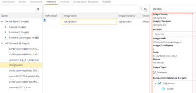

When adding XIQ APs to Site Engine for use in ExtremeControl, I can't find how to ignore them from the reference firmware count. As a result, "Devices without reference firmware" is always red and as such unusable as a quality metric.
Is it possible to either ignore them or in some way "fake" a firmware reference matching whatever IQ Engine version they are running?

Hi Ƙyvind,
you can upload the firmware image to the Site Engine, assign it to the device family, and define the image's version, and mark the image as reverence and your APs running that firmware will be compliant.

You can also take a real firmware for the AP. Download the firmware from the XIQ and upload it to XIQ-SE, define version and make it a reference image.

Thank you, I wasn't aware it was possible to assign manually other than the pre-defined targets in the firmware files. Current version is now accepted as reference by Site Engine.

I can confirm that the solution also works with 3rd party. It's not ignore, per se, but you can actually use the reference firmware function. Upload a dummy file and assign it to the 3rd party device family.
