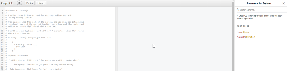

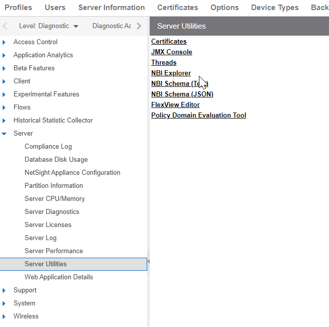

Initially I went to the following URL:
https://<ip address>:8443/Clients/nbi/graphiql/index.html
Via the ‘NBI Explorer’ link in XMC shown below:
Which take’s me to GraphiQL
I was trying to find something in there that lead me to something along the lines of the URL you provided, via the Documentation Explorer on the top right

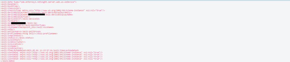

So I initially wasn’t sure how to convert this into the exact line I needed, so I initially run a query using this method
Here is the example:
https://192.168.30.34:8443/axis/services/NetSightDeviceWebService/getAllDevices
I then looked at an entry I already had in XMC for ping only:
And then used that information in that to formulate the string, which now looked like:
https://<enter ip address>:8443/axis/services/NetSightDeviceWebService/addDeviceEx?ipAddress=xx.xx.xx.xx&profileName=<Ping Only>&snmpContext=&nickName=Switch1
After running that it added it into XMC perfectly!
