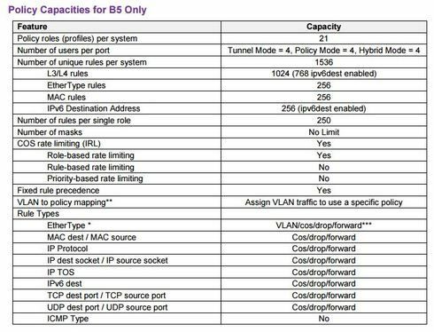

The policy rule would look as follows:
set policy profile 3 name "Test" pvid-status enable pvid 4095
set policy rule 3 ipdestsocket 192.168.100.0 mask 24 drop
This will drop all traffic destined to 192.168.100.x/24.
The policy can be applied to a individual port.
The B5 supports the following Policy Features:
e1b1e3e4572f4675ae6d835fff21da95_RackMultipart20150611-16576-1u46hf2-Capture_inline.jpg

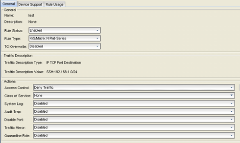

Ronald_Dvorak
Honored Contributor
Looks like it's only supported on some models... like WLAN Controller & K/S/Matrix series.
So set the "rule type" to the device you are need the rule for and give it a try.
Here the example for the K/S/Matrix series.....
dd06c4ed945d4f3783b6de1694af7a0b_RackMultipart20150610-5122-16uvmgn-PM_rule_ssh_subnet_inline.png
