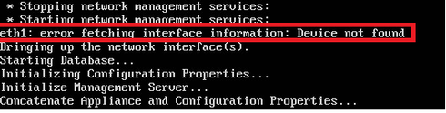

I am installing the virtual NAC appliance to test it, but when I give the configuration parameters fails, it is necessary for the NAC having 2 Interfaces?

As Tyler as mentioned by default the NAC ships with 2 interfaces, eth1 is not configured but should exist. If eth1 is not configured this should not cause any disruptions in your environment, has someone removed Network Adapter 2 from the NAC VM?

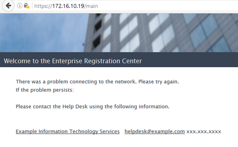

When I try to access the web server of NAC asks me to connect to the network, but it throws this error.
‎09-30-2016 03:24 PM
That actually doesn't have anything to do with that second interface. You should check to see if the IP address for the end system was properly resolved and what state it is in.
Can you provide some guidance on what you're expecting to see?

The OVA ships with two interfaces by default. Did you happen to remove one of the interfaces? The installation script will look for both to start. I wouldn't imagine it would impact the operation if it can't find the second, but most installations that I know of have both interfaces existing on the VM, but the second interface may just be disabled in the hypervisor configuration.
