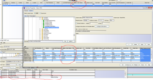

I can't figure out why the UPS reports to the mib tool but not to the Flexview. It seems like it should be either both or neither.

Thanks for your help with this. The issues appears to have been 3 columns that were returning missing values and causing all columns except the mac address to fail to display.
Going forward when trying to build flex views I will add one column at a time.

The HTML does have information but only some scalars, could you back up a level and redo.
All it takes is a single (VALUE packed into the PDU to not respond) and the FlexView will fail.
Now you can add them if they are always going to be there.
So moving all to Request 2 Not (sysName, sysLocation, sysContact) keep these in (Default)
Then you have 12 (new scalars) but I suspect some are not returned.
I cannot verify with the MIB result you provided.

You have xups what appear to be all scalar values.
So 1 or more are not being returned.
You would need to test by moving the request block (3 and 4)
perhaps if you provide the full HTML i can see the issue (on the single device) you are reading.
Other wise just take your time -- adding only a single (Table) at once.
and test across multiple devices - MIBs are not always consistently implemented.
