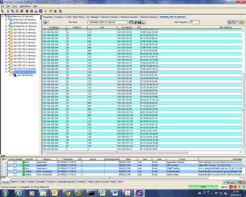

I try to using FlexView to aggregate client's information (IP, MAC, and which port he come from) on swirch
In switch like 430 , 440 it seem no problem, and OIDs I us like:
but the same FlexView I using to show BD8806 's client information , the port will show 6XX 5XX:
Does it need to using different OIDs to show real port on BD ? or it 's using same OIDs , but 645 means slots 6's port 45, it has slot 's mark before real port number?
the second question is I also export this result to html and csv file .
for html it lost mac address 's information
for csv file it lost ReqID
Does it need to change any options 's setting for showing full information when I export?
My Netsight 's version was 6.2.0.221.
Thank for everyone's help.

Question 2: - Export issues with FlexViews there were several bugs corrected in 6.3 related to Export showing consistently the same columns between CSV/HTML. Are you able to upgrade?

switch 's version 15.3
BD 's version 12.4
Did you mean it different OIDs between two version so I get wrong show ?

What all are the exos versions for X430, 440 and BD ?
