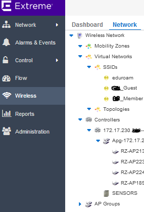

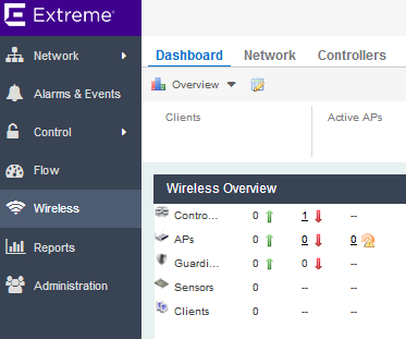

I have create a separate policy domain and import the policies fom the V2110 but netsight showes the controller still as down (Web-Frontend, tab wireless, dashboard, wireless overview)
If I choos the tab "network" instead of dahsboard, I can see the SSID and the AP.
Via "Network" and "Devices" and right click on the controller I can open a web-shell and the controller is reachable via SNMP.
Any ideas why it's still shown as down ?
To enforce the policies now is possible and there is no event message.
Best regards,
Axel
