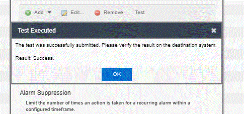

here are the screenshot taked from java console or from OneView:
fac34a99c9284239b00b259888050cb6_RackMultipart20170721-115900-q4zfkk-Capture4_inline.gif
The test seems to be executed correctly, instead the script is not executed.
If I run the same script from CLI on the EMC with the same parameters passed in the action, it ends correctly.
