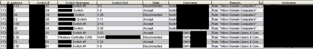

I like to think our NAC is a pretty typical setup. All computers will match on "Allow Domain Computers" and will show up in NAC as "host/%hostname%". When the user logs in it will match on "Allow Domain Users & Computers" and show up in NAC as "DOMAIN\username". See attachment "NAC-Rules.png".
Below is a screenshot of expected behavior:

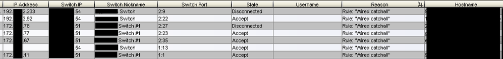

Now I have computers that fail to match on my desired rules and make it all the way down to my "Wired Catchall" rule. One computer I've been experimenting with will not ever match on my aforementioned domain rules and instead goes all the way down to the wired catch all rule.

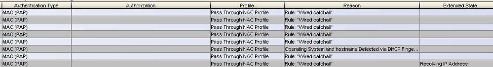

Then I have a computer that is consistently bouncing between different rules- the 3rd screenshot below. Most of the activity occurred in about 11 seconds.
I've noticed all computers that show an authentication type of MAC (PAP) get dropped in the Wired Catchall, and that computers with the authentication type of 802.1x (PEAP) match successfully. While this makes sense to me, I can't figure out why a computer would default to MAC (PAP).

Ok. On that screen shot, looks like you are seeing MAC and .1x auth, I don't see timestamps on the screenshot so it is hard to tell the sequence. The device will do both mac and .1x while authenticating, however .1x will take precedence and have final say on the device authentication. MAC is a just a bit faster to auth, so you will see that hit the catch all rule first then .1x will authenticate.
