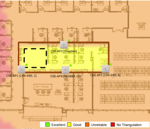

we use NMS-ADV which provides advanced wifi map features with V2110 V10.31.04 (large).
I deployed three APs at the lab broadcasting a wifi and placed APs at a map. " Enable location-based service " is enabled at all three APs. But the map shows not the triangulated position. Instead the position of the client is marked at the AP to which it is connected.
Is it possible to triangulate the position of a wifi device without using a third party Location Service like Aeroscout, Centrak or Ekahau (these are the selectable options at Wifi-Controller / Services / Location-based Service)?

Bear in mind that, since location is calculated, it is VERY important to correctly scale the map and to mark all walls, doors, windows and other obstacles to the signal, with their correct construction materials. EMC will take all that into account to calculate the atenuation suffered by each AP's signal when traversing those obstacles, and better estimate the distance between the AP and the MU.

Triangulation requires at least three AP's seeing the connected user. but those three AP's must be in the same channel.
If you only have three AP's , they will be in different channels (or you would have co-channel interference) and will not meet that requirement. Since only one AP is reporting that user, EMC will highlight that AP and not a trinagulated location.
To do triangulation, you will need to install, at least, two sensors. The sensors continuously scan all channels in both 2.4 GHz and 5 GHz. That way, you will have your three devices on the same channel the user is connected to, and reporting information to allow EMC to estimate the probable location of the user.
