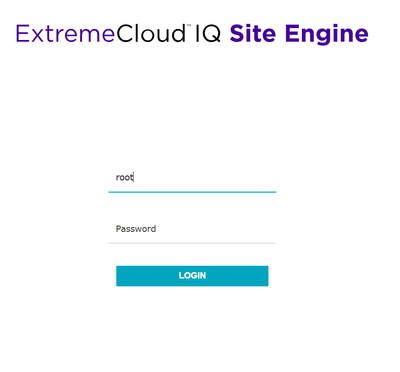

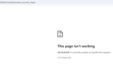

Upgraded to 24.7.10.52 for both XIQ-SE and NAC's.  I could log into XIQ-SE and did so a number of times.  Now, after logging in, I have a page cannot be found please see below with security check in the web address.  Any help with this please?

Hello,
I would recommend a case with GTAC to investigate.
It would be good to look at the status of the nsserver service and any errors in the /usr/local/Extreme_Networks/NetSight/appdata/logs/server.log
The response indicates the server service is likely up, but not in a good state.
Have you attempted to restart the service?
systemctl restart nsserver
Thanks
-Ryan
@Ryan_Yacobucci  - thanks for the email.  Yes, the services were restarted and the logs checked.  GTAC advised updating to v25.08.13.02.  This has resolved the issue.
