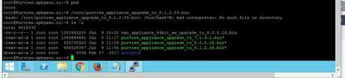

It shows this:
5df67af0c9ee415fb8c7e5282effa040_RackMultipart20180609-129124-133ucqz-__________inline.jpg
StephanH
Valued Contributor III
Hello Ilya,
what shows the command "ls -l" in your working directory?
Best regards
Stephan
