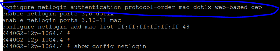

Hello,
Check the switch configuration for netlogin precedence settings:
Do you happen to have MAC before dot1x?
show config netlogin:
Control will always assume dot1x to be the higher precedence.
Thanks
-Ryan
