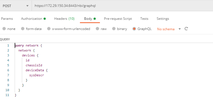

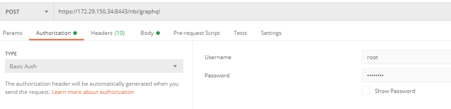

I’m able to connect with Postman with basic authentication, but I’m not able to translate the same GraphQL query in manner that works with the ansible uri module:

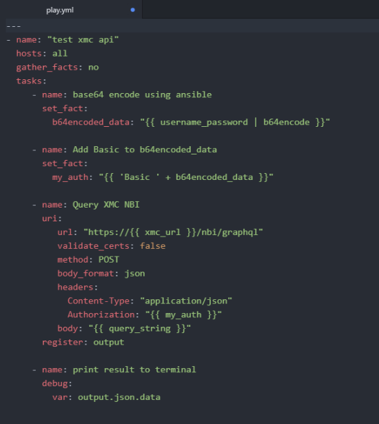

I’ve made a simple test with Ansible AWX (the test is very elementary).
My ansible file is the following:

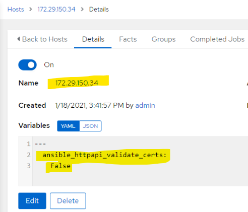

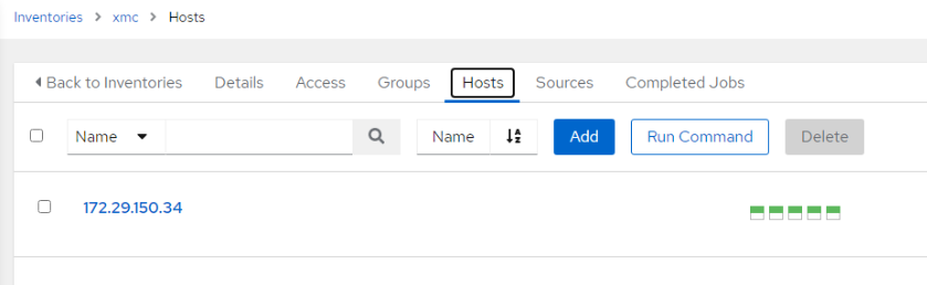

My host that is XMC server is defined as:

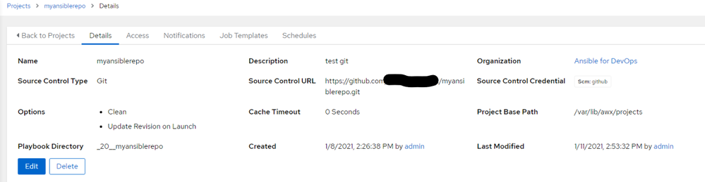

My project file (play.yml) is source fro github repository:

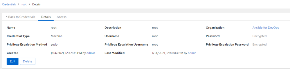

I’ve defined the credential to use for xmc :

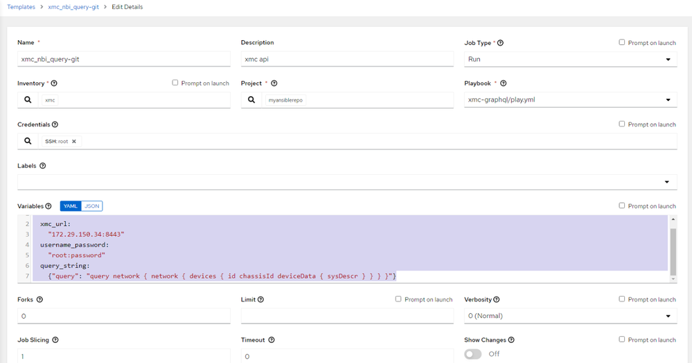

And finally my Template is defined as follow:
And the variables that I’ve defined in the template are (with the query that I want to run as GraphQL):
  xmc_url:
    "172.29.150.34:8443"
  username_password:
    "root:password"
  query_string:
    {"query": "query network { network { devices { id chassisId deviceData { sysDescr } } } }"}
