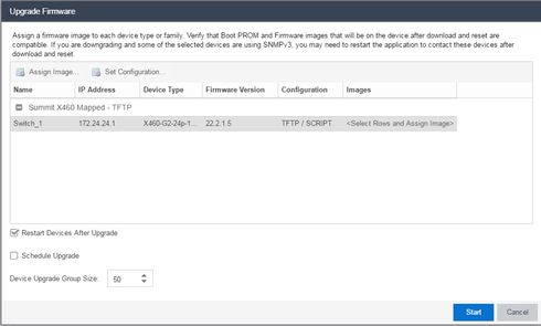

‎06-16-2017 04:18 PM
As you'd see per default "Restart Devices After Upgrade" is set.
That restart/reboot would explain the alarms that you get.
