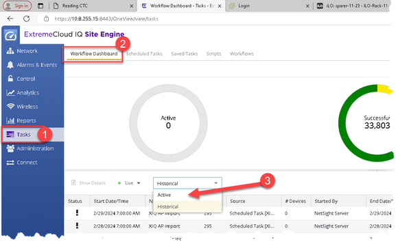

I have a couple of workflows that take time to run (one is about a minute, the other is a few minutes). Is there some way I can have an update showing on the screen to say it still running? Both of these workflows traverse all the switches, so switch IP's would be one possibility.

‎02-29-2024 08:33 AM
use the Workflow Dashboard, please. You will be able to see if a workflow is running or witch which results in they ended. But you will not see any activity details during runtime.
‎03-01-2024 06:29 AM
Thanks for this. I was thinking this would be the solution, but hoping for better.
