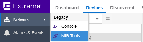

- open the tool...

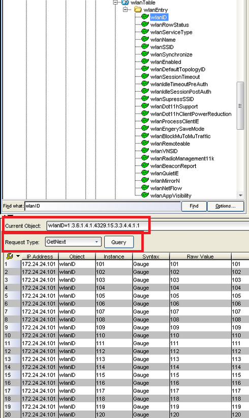

#WLAN services = wlanEntry = 1.3.6.1.4.1.4329.15.3.3.4.4.1
Every WLAN service has a unique ID which you could query with wlanID=1.3.6.1.4.1.4329.15.3.3.4.4.1.1 so let's run that....
The result is the Instance# for all of my 20 WLAN services.

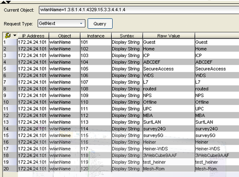

Now we know the Instance but we'd like to get the name for it = query wlanName=1.3.6.1.4.1.4329.15.3.3.4.4.1.4

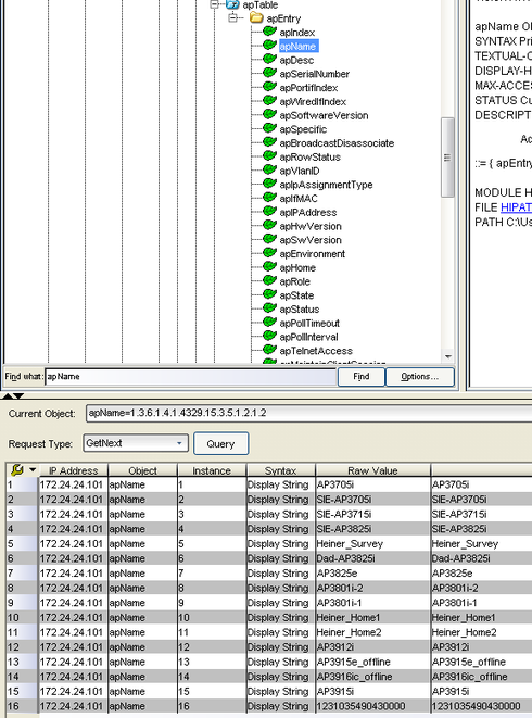

#APs = apEntry = 1.3.6.1.4.1.4329.15.3.5.1.2.1
Again we'd query the apIndex to get the unique AP index# and then query other fields, in this example the AP name.
