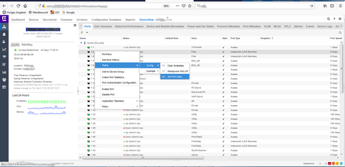

i want to use a port based XMC (TCL) Script in Device View for setting Port Alias on an EXOS Switch
771304116ab94775ac9b5cd15f487970_RackMultipart20181110-122925-fh8rzi-XMC-Device-View_inline.png
i know there is another point within XMC to set port aliases but first i need this here (fewer windows changes in daily business) and second i wants to know how to insert user input in such kind of port specific XMC scripts.

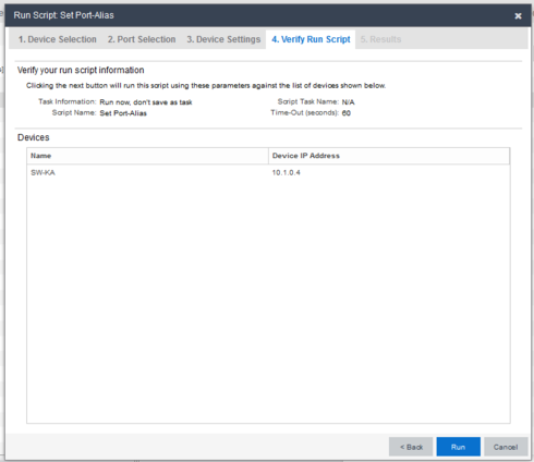

771304116ab94775ac9b5cd15f487970_RackMultipart20181110-60988-jzao8p-Script0_inline.png
But unfortunately the script does not request the input for variable $PortAlias.

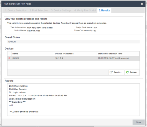

771304116ab94775ac9b5cd15f487970_RackMultipart20181110-38360-geh7aa-Script1_inline.png
it runs into an error because variable $PortAlias is empty.
771304116ab94775ac9b5cd15f487970_RackMultipart20181110-97241-6hbf66-Script2_inline.png
How can i trigger that the input was retrieved and can be set via CLI successfully ??

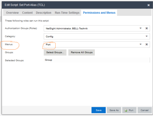

With the help of Stephan i can get the script file running.
I do some mistakes in the header sections - it is important to look at the start and the end of the sections. Input fields have to be within the MetaData Section ...
Another problem is that i use $port Variable as $Port which is not the same = case sensitive
