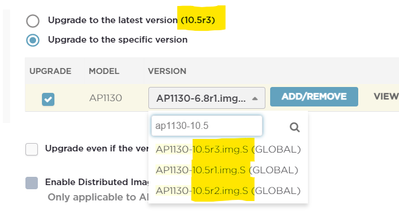

I noticed that firmware for the AP650(AH) is out, with the new version being 10.5.4.0.
I updated a few of the AP's that had zero clients, startign on my AP650(ah)'s, and then went to update the firmware on the AP1130's. thats when i noticed that 10.5.4.0 wasnt an option, only the previous version 10.5.3.0.
Whats going on?  since ive had this system (since Aerohive) its been the same firmware for the AP650's as it has for the AP1130's.
Dont tell me that the firmware is going to start to diverge based on the model of AP... please dont tell me that.... not a good idea..
Anyway, im interested why the latest isnt available for the AP1130's, anyone?

Well, the AP1130's have a firmware update.  Im re-posting this, as I did post again, but it didn't show up here.  Reposting it, this time as a reply to my first post may help with that.
Here is the version number:
10.6r1a and it takes about 7.5 minutes to fully update, along with two reboots, which makes me think this is a security fix - No release notes on that version so far, so i am guessing its a security fix.
Anyway, wanted all to know that check posts here.
Thanks,
J.

Well i tried again this morning, and updated a few AP650(ah)'s to 10.5.4.0 without any issue, it shows up in the "upgrade to latest version", as well as showing up in the dropdown list.
I then selected a single AP1130, and "upgrade to latest" shows 10.5.3.0, and the same for the dropdown.  Here is a picture of that:
Im going to give it until the end of the week, and then ill create a GTAC ticket if its still not allowing the latest firmware.
