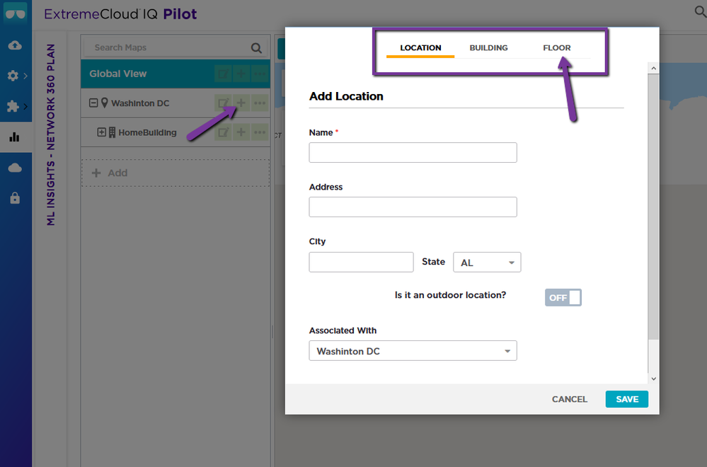

You can add a new floor to your maps by going in to ExtremeCloud IQ> Go to the ML Insights tab on the left hand side of the page> Go to Network 360 Plan> Find the location you want to add a floor to and click the plus icon next to the location name> You should see a new window pop up and at the top you should see Location, Building, and Floor> Click over to the Floor tab and you should be able to create a new floor for your location. Here is a picture to show the area I’m referring to:
Is that what you were looking for?

ML Insights (Graph icon on left menu) > network 360 plan
Here you can add location, buildings and floors.
