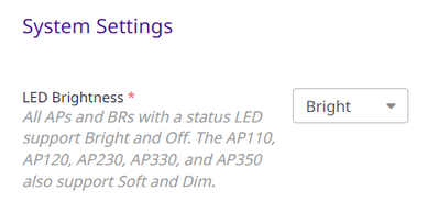

Hello,
From you network policy, additional settings, Management Options,
System Settings, led brightness:
Cheers,
Christophe

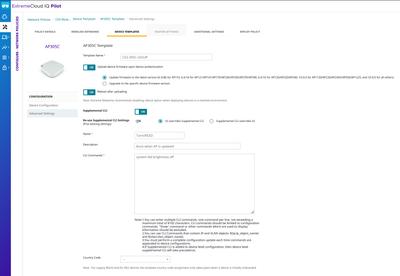

Hi ascoyne,
I previously did it through the templates, for the multiple APs in the theatres. Reference the screenshot below. While checking this just now, it seems a cloud update disabled it at some point, so I'll have to test it again and look into Christoph's response. I generally need them to align with templates, though, so my initial assumption is that the solution wouldn't suffice.
