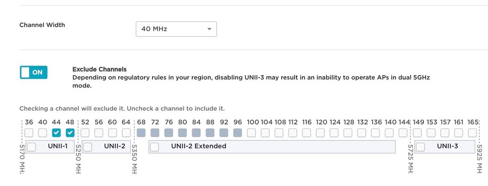

Is there a reason why its only possible to exclude 20 MHz 5GHz channels and not 40 MHz channels?
Wouldn’t it make sense if channel width is set to 40 Mhz to switch to 40 MHz channels?

Could it be that because of the above the wireless expert who is behind the CloudIQ code gave us the option to exclude i.e. channel#40 so we’d make sure channel#36 is always the primary channel.
If you checkmark all channels and leave only 36 and 44 would that result in the APs using only 36+ and 44+ ?!
No idea but someone could give that a try. Then the option would makes sense.

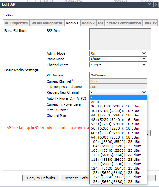

Below a screenshot for the IdentiFi platform, the channel in the [ ] is the primary channel.
Even 40Mhz is set you have all channels listed to make sure that you’d choose the primary channel that you prefer in the manual channel select pulldown section.

That does seem like it would make more sense, yes. I’d recommend filing a feature request with your SE to see if we can get that functionality added in. If you’re not sure who your SE is, please let me know and I’ll email that information directly to you.
