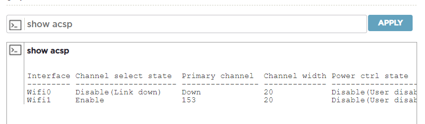

‎05-26-2022 10:08 AM
Well this is just fricken great.
I did the commands (thanks for those BTW), and this is what it shows, and for both those AP's where the power on wifi0 is showing as auto:
So wifi0 is disabled on those 2 AP's... just bloody marvelous. Selecting to revert them back to template default isnt working either. ive done that several times with those AP's and still its showing Auto.
I DO NOT want to have to factory reset them, they are mounted to ceilings.... this is unreal...
