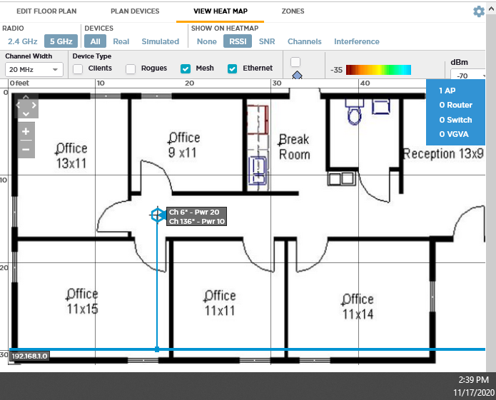

I just took a look at this in my lab, if I’ve got an AP set to dual 5GHz and the heat map is set to 5GHz, I see both 5GHz channels listed. If I toggle over to 2.4GHz I do see Auto, but 2.4GHz isn’t in use currently. I ran this test using an AP305c on 10.2.2.0 just for comparison. If both radios are on and using 5GHz, you should see both channels listed on the heat map, so I might suggest opening a case for this one.
Here is what I’m seeing in my lab currently:
