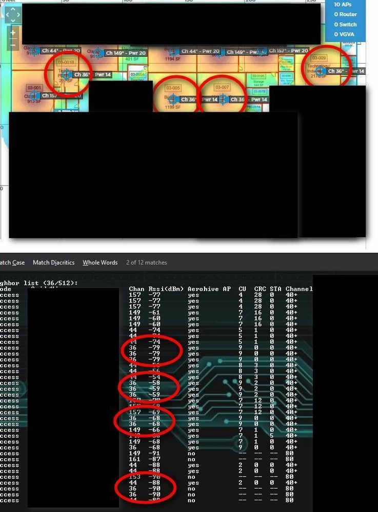

I’ve been seeing many instances where APs are on the same channel as their neighboring AP with RSSI in the 60s or 70s. I’m looking for steps to take to prevent this that don’t require manual channel plans, as I have too many APs to manage in that manner (wish this wasn’t the case).
In this one example I’m trying to figure out why the two radios are showing drastically different channel costs. full disclosure, not really sure what these numbers mean or how they’re calculated so any info or resources are greatly appreciated.
Also of note, these Radio Profiles are set to auto power selection with max power of 14dB. There are 50+ APs at the site (apx every other room), yet every AP is running at power 14. none have adjusted power down at all. Is this typical? My understanding is that even if Co-channel and adjacent channel interference are minimized, RF should still be kept to minimum power necessary to avoid general interference.

@john_kern In your heatmap screenshot you have 10 APs, if both radios are in 5ghz that’s 20 channels.  Looking at your ACSP channel cost screenshot you have 4 channels on the low side of the 5ghz band and 5 on the high side, for a total of 9.  So for that small area you have 9 available channels for 20 broadcasts.  ACSP is doing a bad job because there is so much overlap.  Enable DFS and ACSP will do a better job.

Here’s another example I just came across where it appears ACSP is struggling. I find it interesting that only the APs on ch36 have adjusted radio power down, while all other radios are running at max allowed power (20dB in this case). I will admit, this device template needs tweaking as it’s meant for lower density deployments, and this site has a higher than typical number of APs, but it does provide a good example of what appear to be the current limitations or deficiencies with ACSP. ACSP Neighbor CLI is from AP in 03-005
