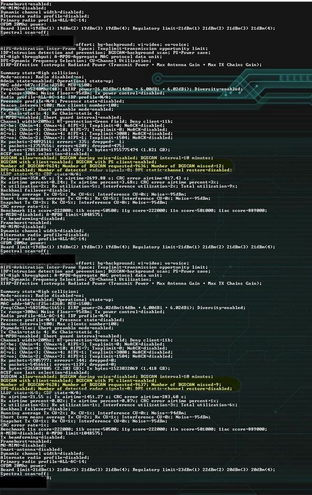

I’ve been seeing many instances where APs are on the same channel as their neighboring AP with RSSI in the 60s or 70s. I’m looking for steps to take to prevent this that don’t require manual channel plans, as I have too many APs to manage in that manner (wish this wasn’t the case).
In this one example I’m trying to figure out why the two radios are showing drastically different channel costs. full disclosure, not really sure what these numbers mean or how they’re calculated so any info or resources are greatly appreciated.
Also of note, these Radio Profiles are set to auto power selection with max power of 14dB. There are 50+ APs at the site (apx every other room), yet every AP is running at power 14. none have adjusted power down at all. Is this typical? My understanding is that even if Co-channel and adjacent channel interference are minimized, RF should still be kept to minimum power necessary to avoid general interference.

If Co-channel interference is “the top cause of needless airtime consumption “ (https://www.extremenetworks.com/extreme-networks-blog/whats-the-biggest-cause-of-co-channel-interfer... ) and it’s often recommended to have 20dB RSSI channel separation (https://www.metageek.com/training/resources/adjacent-channel-congestion.html), that leaves this area as an issue for any client not connected to ch48 at better than -46dB RSSI.  I haven’t surveyed this particular location, but I think it’s save to say this separation would become even less likely for clients located in between these two APs on ch 48.
Given all that and my current understanding, I’m trying to wrap my head around how having two radios on the same channel so close to each other isn’t a problem?
Also of note, channels 44 & 153 aren’t even being used by any APs in the area. Any ideas why this would be?

Thanks for that output, those are the background settings I’d recommend so we’re good there. We got some of our senior engineers to review the output you’ve shared and it doesn’t look like the APs would need to lower their power at the moment. We usually don’t see issues until we hit the -50’s RSSI range and up, so those -66 RSSI values on channel 48 shouldn’t be causing any issues. From the outputs you’ve shared here, it looks like the radios are balancing properly at the moment.
As for the disparate channel cost values, if the AP is acting in dual 5GHz mode it’ll split the 5GHz channels between the two radios, so it’s likely that the higher channel costs are associated with the channels that radio is leaving for the other radio to use instead.
