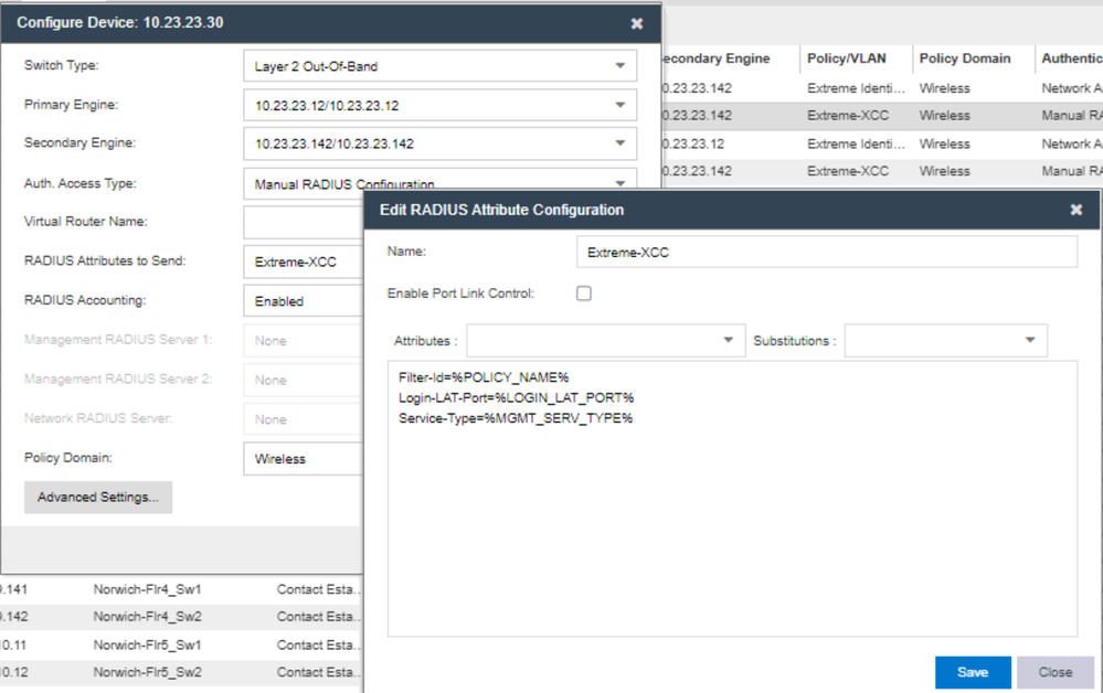

I have this in the RADIUS Attribute configuration:

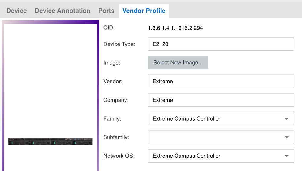

For the SysObjectId, go to the device in the configure menu.
You have a vendor profile tab with the OID

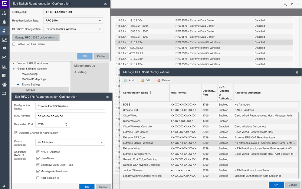

Here my CoA settings:
- Filter-Id=%POLICY_NAME%
- Filter-Id=Enterasys:version=1:%MANAGEMENT%policy=%POLICY_NAME%
- Login-LAT-Port=%LOGIN_LAT_PORT%
- Service-Type=%MGMT_SERV_TYPE%

The issue was that the XCC was showing a OID in the vendor profile where there was no matching OID in the ReAuthentication in ExtremeControl.
Once I added it, it all started working.
