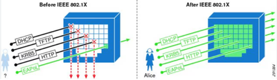

When the switch port/or wifi is 802.1x enabled, only EAP traffic is allowed. So, no matter how much the end-system is sending DHCP Request, this traffic will not be allowed to pass through the port. Therefore, the DHPC Relay configuration pointing to ExtremeControl will have no effect. Am I right or wrong?
I created a rule in the NAC to authenticate via 8021.x only end-system running Windows 10 and 11 and when the end-system is first seen, the NAC didn't know who it was.
The switch is sending the DHCP request to the network, the NAC is receiving these DHCP Requests, however, this is only sent when the challenge imposed by the EAP is processed. Before this, only EAP traffic passes through the port or wireless network.

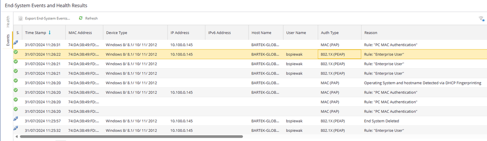

I've found solution which works for EXOS switches. Keep in mind that in EXOS you can enable both MAC-based and 802.1x authentication which works concurrently which allows then the NAC to do something like this:
So just create a rule for MAC-based authentication which gives a limited access to for Base Services (ARP + DHCP) and 802.1x rule with device profiling and it works
