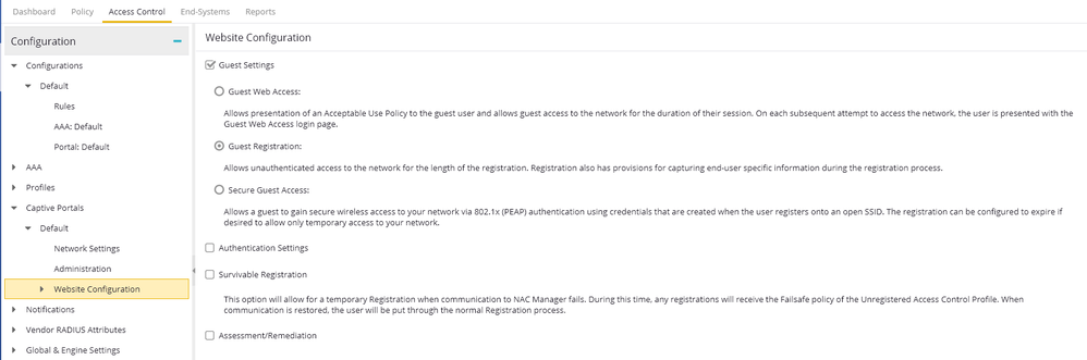

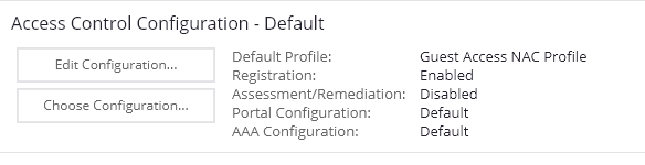

Hello,

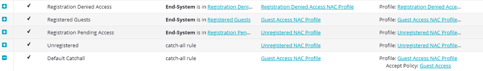

I've configured an Open SSID on a network profile in XIQ and it is visible from my AP. If I connect to the SSID a web page pops up prompting me to Connect to a Wi-Fi hotspot and Connect to a sign in page. When I click Connect nothing happens at this point. This is in Windows 10. Not sure if the issue is with Control or XIQ? I see my machine in End-Systems against Open SSID and it hits Unregistered rule. I'm expecting a registration page?

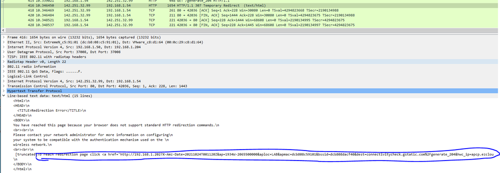

That is correct. There must be SOME mechanism in the network to redirect client traffic in order for NAC to send it's captive portal. Traditionally that was a PBR in the core router to send internet bound traffic to the NAC.
Mostly today we see AP/Controller based redirection mechanisms that perform this task.
https://extremeportal.force.com/ExtrArticleDetail?an=000082067
The AP/Controller will spoof the destination site and send back a redirect error code with the a new URL that is the NAC appliance. The browser will them directly contact the NAC to display the captive portal.

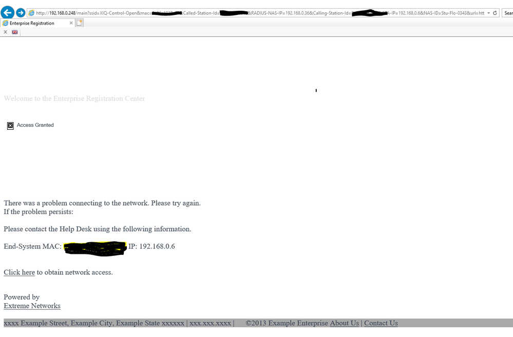

On a different laptop I see in the URL display a connection to my EAC with Called-Station-Id (my MAC blacked out below) and a Welcome to the Enterprise Registration Center. Access Granted. If I click Click here to connect it redisplays the same screen. Again, not prompted to enter user details and register.

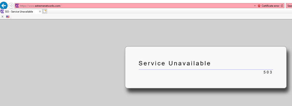

0ab42f242efe44c59ddbceb74c9877da.pngFinishes with Service Unavailable 503.
