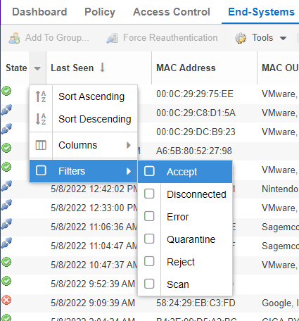

How can I see information about failed authentications in Control, is there a way to list the MAC addresses that have failed MAC authentication?

Hello,
In the end systems tab you can filter on "Accept State"
You can then filter on Authentication type of MAC to see all end systems currently rejected.
If you want to trigger an email based on a specific event go to Control -->Access Control --> Configuration --> Notifications
You can build a notification to send an email if triggered, or execute workflow, syslog event, or script.
