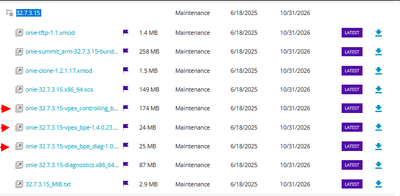

I have Extreme Switch x590 and i want to try to upgrade firmware in xmod.
I found n°3 files, what is this?
Where can find procedure?

Hello,
XMOD files are optional software components that 99.999% of customers do not need. The specific XMOD files that you have highlighted are for the VPEX Virtual Bridgeport Extenders (V300 and V400 hardware models).
If you are not using VPEX with V300 or V400 hardware, you will never need these XMOD files.
If you ARE using the V300 and V400 hardware models, then you can find more info about VPEX XMODs here:
https://extreme-networks.my.site.com/ExtrArticleDetail?an=000081634
