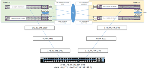

Have a OSPF issue that I must be missing something obvious. Basically I have some EXOS devices activing as the core OSPF backbone area. At the edge I am using a EOS C5 switch configured as an OSPF Stub area.
The two have created a neighbourship between them, and I can see this in the LSDB tables.
The problem is I can't see the routes from the edge showing up on the core. This is the one I'm interested in at the moment:
172.20.0.254 255.255.255.0
Here is a quick diagram:
Here is the OSPF config on Core 1 (only one connected at the moment), the points of interest are via the P2P VLAN "OSPF-Col-BSD-CEF" and area 172.20.192.254 :
